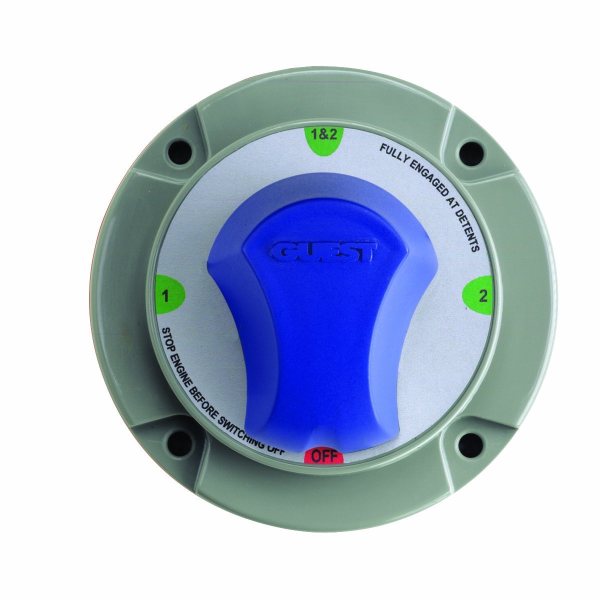

One of the better ways is to use a manual Isolator. You can get them at a automotive stereo shop. It looks just like the old solenoids in cars except bigger. Has a hot wire in from battery, a ground wire, a remote go wire and a hot out to the batteries. Keeps the rear batteries from draining the main batteries and yet lets them charge when vehicle is running. You don't need to vent them if: A. You use Optima type batteries (I run two of the blue top marine style) or B. You get a couple of the dry cell from a automotive stereo shop. Make sure to run HEAVY duty fuses (such as the 150 amp type fuses you get at a stereo shop) at both points where you come off the battery and where the battery wire goes to the two auxilary batteries. I keep the Optimas under the rear couch/bed and that seems to work well. I used the automatic isolators like you can get at a rv shop or some auto parts stores and find that I like the manual one better (don't let the word manual through you, you don't have to do anything). Hope this helps you.

I myself use a true manual switch.
I have my batteries under the floor behind my driver's seat and the switch in the cabinet above them. I need 12 feet of cable (one way) to reach the engine battery. I need 11 feet of cable to reach the battery switch from the alternator.
When I added another 2 AWG cable from the alternator to the battery switch and another between battery and ground, my charging amps at higher RPM's increased about 120%.
My 130 amp alternator is only capable of 32 amps at idle speed, when hot.
If you want your batteries to last( for years), you must think of the alternator as only able to supplement what your stereo use. Even with an upgraded charging circuit/ system, 2 depleted batteries are going to require many hours of driving with engine rpms above 1800 to fully charge them.
Since this is not usually feasible, you should have a good 3 stage automatic battery charger, and plug it in when you get home. Have a convenient way to do this and you can get 5 years or more out of your batteries, and never have them let you down during an outing. If you don't, your looking at about 2 years.
