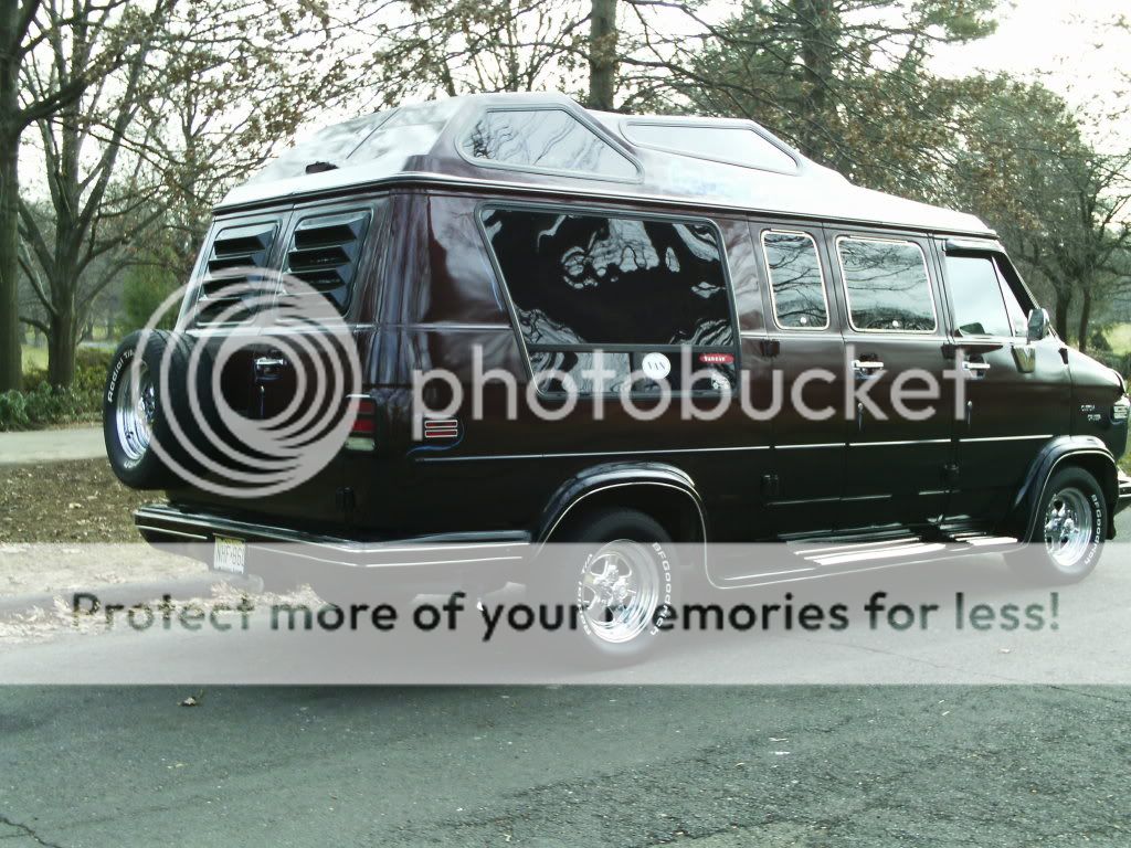

I had the same issue with the rear end sagging. I found a local shop that specializes in leaf springs do the job. On their suggestion I had them replace the original 2500 springs with a new set of 3500 springs. It did raise the rear up about 4" But that's the look I was going for. I think the cost was about $230 and they were done in a few hours. Here is a pic with the new ride height.
#553270 - April 02nd 2012 12:13 pm Re: Rear Leaf Springs [Re: UTAH]
Posts: 15408
That stance looks good Charlie
