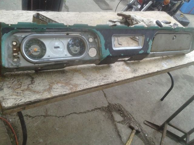

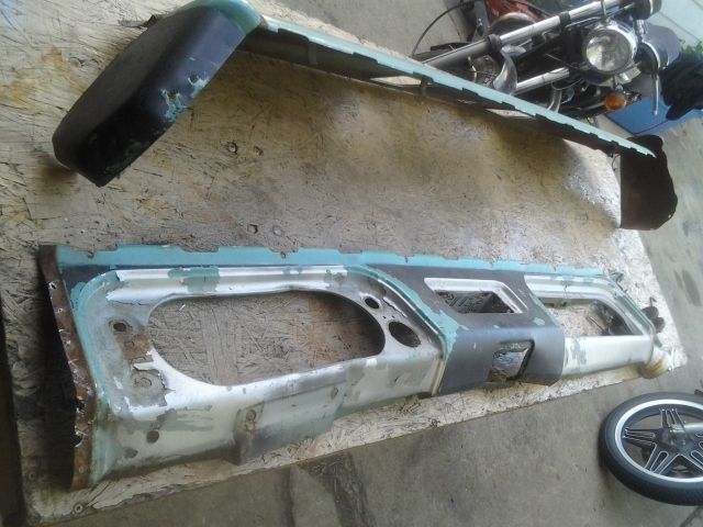

Well, I gotta start somewhere, so I might as well tackle the dash. Replacing the gutted dash with a complete unit will help stabilize the front end when I start cutting away the roof.
I have this dash I got from Duane in Eastpointe about 10 yrs ago when he replaced the front clip of his 70 GMC after a crash. It's bent in a couple places, and the radio was cut out for a 1/2 DIN head unit, but it's better than the gaping hole I have now.
I only need the face portion, so I will remove the end caps and cut the top portion off at the slots.
I start by chiseling the spot welds....
Then I cut between the slots (gotta love air tools!)
You can see how the dash is bent in this pic
Much like Ash in Army Darkness had his boomstick, I have a bangtable. Everyone should have a bangtable, it's great for sheetmetal work
I got into pounding out the dents and didn't get 'during' shots, but it's hard to do this and hold the camera anyway.
It's mostly just pushing and bending and pounding things back in place.
After the 'massage'
A little inspiration, hope to be seeing this soon from the driver seat!
Edited by Astro (June 12th 2012 8:54 am)
Edit Reason: fixed image links

cool! How did it get that bent in the first place?
Got it from a friend who rear ended a car with his early (Power disc brakes stop quicker than manual drums, apparently), I got him a front clip and he gave me the bent dash so I could fix mine.... this was about 12 years ago.

Gotcha. Looked like a massive knee jab to the middle of that thing.
